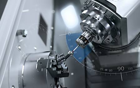

  • Toolkit for checking and correcting the kinematic
  • Accuracy of 4- and 5-axis machine configuration
  • All head variations and table axes
Customer Benefits
  • Periodic recalibration of the machine with comprehensive documentation
  • Highest kinematic accuracy in self-regulation
3D quickSET
Define kinematics head
3D quickSET
  • Measurement and correction of the position of turning and Pivot axes (C4, C3, B)
  • Sag compensation possible
  • Can be used in combination with standard probes from customers (recommended Renishaw, Blum)
Customer Benefits
  • Reliable re-calibration of the machine before a highly precise processing
  • Continuous documentation of machine accuracy
  • No rejected parts due to unknown Geometric-deviations.
