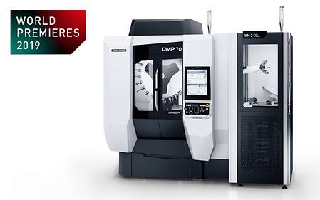

DMP 70
VERTICAL HIGHSPEED MACHINING CENTER FOR SERIAL PRODUCTION
DMP 70
  • Workpieces up to 400kg in a footprint of <4.3m², X/ Y/Z =700 ×420 ×380mm

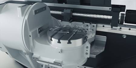

  • 5-axis simultaneous machining with direct drive table, 100 kg maximum load*
  • 10,000 rpm inline spindle with 78Nm in the standard version, optional 24,000 rpm with 12Nm or 20Nm (BT 30, SK 30* )
  • Ideal for automation, connection options from the left, right or front
  • 5µm positioning accuracy with MAGNESCALE linear encoders
  • Up to 2g acceleration for the shortest possible chip-to-chip time of 1.5sec
  • toolSTAR tool magazine with 15 or 25 pockets*
  • Process-reliable Design for production: steep covers in the work area, centrally arranged chip conveyor* , internal doors and central access for maintenance from the back
* optional
WH 3 CELL FOR THE DMP 70
  • Recirculating magazine for workpieces up to 5.5kg (single gripper), double gripper up to 3kg
  • 300 × 200mm max. workpiece size
  • 50 or 100mm max. workpiece height (carrier-dependent)
  • 8 or 15 workpiece carriers with 515 ×315mm effective surface and each with a 20 kg load capacity
